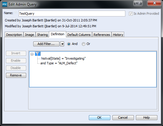

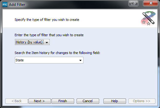

    Mar 16, 2015 6:44 PM UTC
    You would need to query for them using the History (by value) condition.
