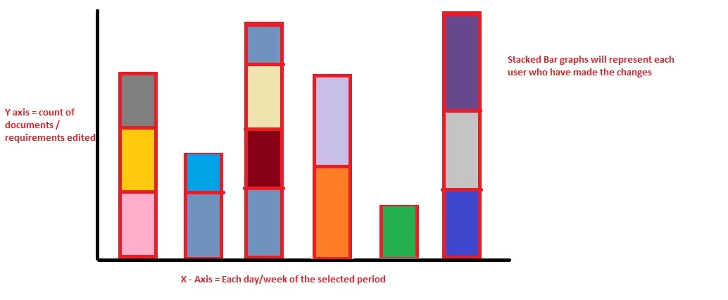

How to use Computation field (xyz) in "Item Field Trend" Type Chart of Style Vertical Stacked Bar.
I have Computation field (xyz) which gives me count of Requirement/Document (Content/Segement) modified by particular User.
I have Query which gives me all users, also I have query which gives me Requirement/Document (Content/Segement) modified recently.
We required the attached graph.
