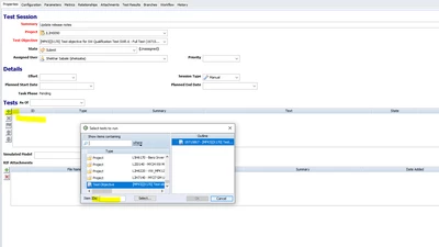

One more quick help required.
Want to update field is equal to Tests  with my testcase IDs in Item ID's as shown below in picture.
It shall take IDs with space in between. What shall be command to do this?
Thanks in advance.

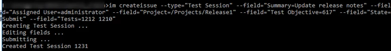

Hi SS_10728259,
You're right. If related item ids are multiple, then use a space to split them.
im createissue --type="Test Session" --field="Summary=Update release notes" --field="Assigned User=SHEKHAR SABALE" --field="Project=/L2H0090" --field="Test Objective=19715867" --field="State=Submitted" --field="Tests=id1 id2..."
Here is my test result:
Ivy
