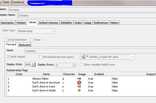

    While I have your eyes... I see things like this in the issue output: 94005ay 94004xyz
    Any idea what "ay" and "xyz" mean?

    Feb 6, 2013 8:06 AM UTC
    Hi Eric,
    the character you see are relationship flag indicators.
    They are defined by your Integrity Administrator.
    e.g.
    If you can see the character, it means that the flag is TRUE.
    Regards Matthias
