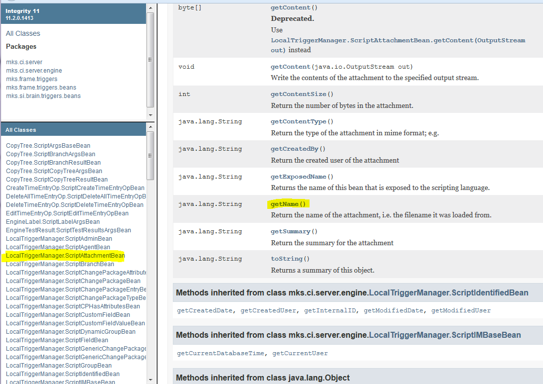

Thanks Awalsh it worked. Can u tell me is there a way by which we can know the filename which is attached to the long text field as attachment. Since it is copying all the attachments present in that particular type which I dont want
Jul 18, 2018 1:21 PM UTC
You can get the filename with getName() from the attachment bean.

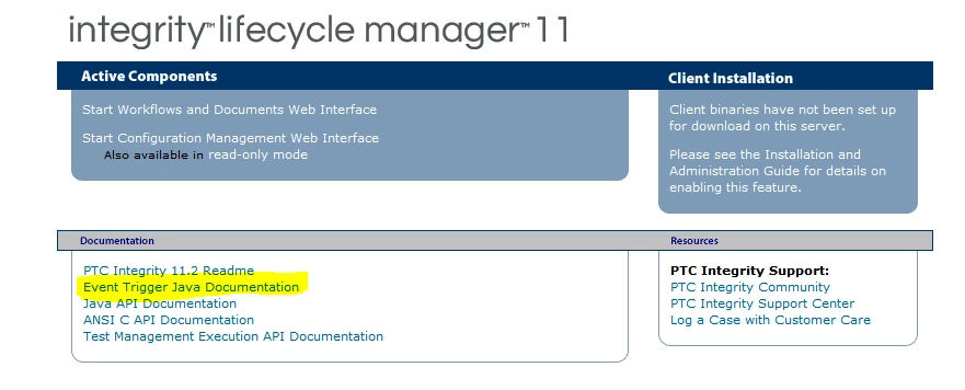

FYI: you can see all the methods and beans in the java docs. From your Integrity Server homepage, click on "Event Trigger Java Documentation", then select the bean you want from the left hand side:
AttachmentBeanJavaDocumentation
