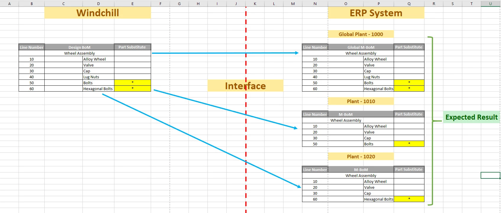

Hi Experts,
We are currently challenged with the below attached use case as it is at this point a manual task. Any suggestions or ideas are welcome:)
Expected Results:
  1. Should be able to see whole BoM structure (similar to Design BoM) released to Global Plant in ERP system (refer below attachment).
  2. Should be able to see BoM structure released to specific plants with only necessary Part Substitute picked in ERP system (refer below attachment).
  3. To follow Digital Thread/Traceability, how to make sure that the correct Part Substitute can be assigned when building Process Plan from M-BoM.
  4. Is it a possibility to use Alternate BoM approach? If Yes, then how to have the structure created which fulfils below expected results?
Looking forward to get wiser with the recommendations/ideas shared.
Thank you in advance.
Stay Safe...!!!
Praveen
