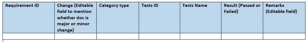

I want to create a custom report with requirement ID, tests ID, tests name, result, and few editable fields.
Could you please suggest is there any way to do in Integrity report. I'm using Integrity 11

  1. A Requirement can be linked to multiple Test Cases and a Test Case can be linked to multiple Requirements, are you aware of this? – Yes, so to summarize one requirement specification document can have many requirements and requirement can have many test cases
  2. Field "Change": not sure what this means. You want to add a comment here about what exactly? Currently we mention manually whether its major change or minor change. So I thought we can have editable field where we can mention on the go but at the same time it should be saved somewhere to avoid rework.
  3. Category Type: we do have a Requirement Category, and a Test Case Category, which Category do you mean? Yes that’s what I meant type of document.
  4. Tests ID: Do you expect to list here multiple IDs? Yes all tests belonging to that particular requirement.
  5. Tests Name: What is this exactly, the Test Case Text? Every document has a name it becomes easier to identify by name so whatever name (title / text) we have maintained in PTC for that particular test case should be displayed.
  6. Result: You plan to enter it here? Test result Passed / Failed
  7. Remarks: You plan to enter it here? Currently we mention manual remarks about why particular test case not executed or whether we reusing from previous cycle. So I thought we can have editable field where we can mention on the go but at the same time it should be saved somewhere to avoid rework.

a) if possible, use the Build-in Test Result Editor from Integrity
b) Offline Test Result editing is very often requested, and we have implemented an Offline Excel solution  which allows customers to enter Test Case and Test Step results and send them back into Integrity when again online.
c) Adding the Requirement Details to Test Result entry forms is not that common, but makes sense especially when you plan to perform a QS action.
d) further more we have implemented different kinds of reports, in html, Word, Excel .... to serve as Test State Reports. They are usually customer specific, although the way how we retrieve data from Integrity is highly standardized.
e) Also ThingWorx could be used to become a front end for Testers, in case there is a need for Web based Test Result entry.
Adding an example of the Excel Offline Template ...
