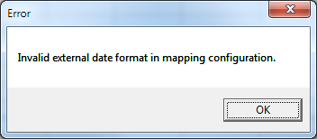

What is the date format string for the XML file (Gateway?) that defines the mapping between Integrity and MS Project fields? The one that is in the sample file doesn't work. It's something like "EEE MM-dd-yyyy" and it throws an exception.
I am using Integrity 10.7 and MS Project 2013.

    Should I just open a case for this? The error I get is:
    May 26, 2016 12:53 AM UTC
    My date format in MS Project is:
    My external-date-format string is: EEE M/d/yy
    Shouldn't these be a match?
    I've also tried:
    EEE M/dd/yy
    EEE MM/dd/yy

    May 26, 2016 5:58 PM UTC
    After running the troubleshooting steps at https://support.ptc.com/appserver/cs/view/solution.jsp?n=CS121128&lang=en_US I checked the logs. The log file projint.log told me to use yyyy-MM-dd HH:mm:ss. This format worked for me.
