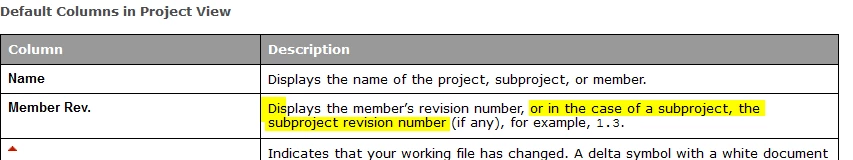

Hi all,
in SI ("Configuration Management") you can see in the project view in the column "member revision" the revision number of the members contained in a project. In the helpfile (http://<servername>:<port>/integrity110_hc/index.jspx?id=client_proj_opening_projects.mif-2&action=show) you can read that this column also shows the revision of contained subprojects:

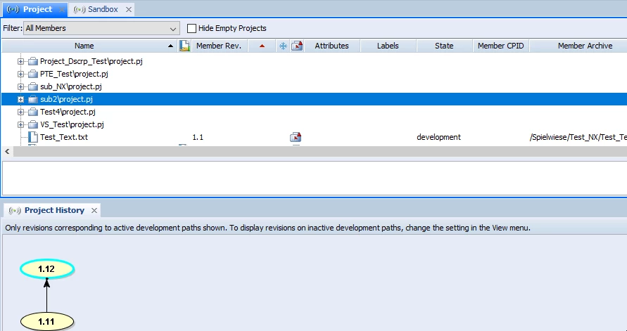

But this is not the case in our system (ILM 11.0.506):
As you can see in the project history, the selected subproject has revisions up to 1.12, but in the column is nothing to see.
I also don't remember that this would have been the case in previous versions of Integrity. I'm asking here if anyone else sees the revision of a subproject in the project view and we have a misconfiguration somewhere in our system?

Nov 22, 2018 4:58 PM UTC
I think it's a documentation error rather than your system. I haven't see the subproject revision show in a long time.

Dec 11, 2018 11:23 AM UTC
I guess you might have seen that in a build sandbox
or a build project view.
Projects and sub projects do not have a revision but a "current state", unless
a special build resp. checkpoint is referenced.
I guess this is meant with "(if any)" in the documentation.
HTH
