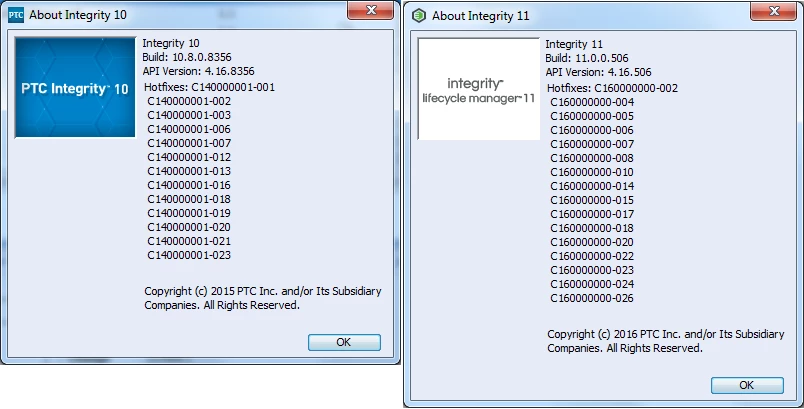

Do the PTC Integrity 11 and PTC Integrity 10.8 clients work with Java 64 bit runtime as well?
We have at office both Integrity  Client 10.8.0.8356 and Integrity  Client 11.0.0.506 (see attached image)
Both versions have a 32 bit JRE in "C:\Temp\IntegrityClient10.8_2\jre" and respectively "C:\Temp\IntegrityClient11.0\jre"
If I overwrite the JRE folder with a 64-bit version of Java, is it all right or not ?
So the question is: do  the PTC Integrity 11 and PTC Integrity 10.8 clients work with Java 64 bit runtime as well?

No, we only have 32-bit versions of the clients. If you overwrite the jre directory under IntegrityClient, your Integrity Client will not even start.
