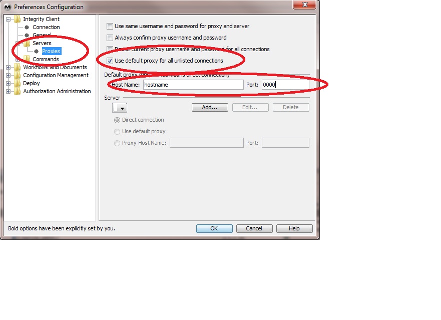

I need the command that will set the hostname and port for proxy server via integrity cli and also check the box "Use default proxy for all unlisted connections" like shown in the attached picture.

found the commands:
-- proxy setting:
si diag --diag=setproxy --param=$HOST:$PORT --param=$FSA:$FSAPORT --target=client

    you can use the following command to set this setting:
    si diag --diag=setproxyprefs --target=client --param(proxyUsedefault|proxyConfirmuser|proxyGlobaluser|proxySameuser) [--param=(true|false)]
    So set final command woudl be:
    si diag --diag=setproxyprefs --target=client --param=proxyUsedefault --param=true
    Unfortunately this command is only documented in the Release Notes of 2007 SP6:
    http://www.mks.com/support/productinfo/docs/releasenotes_S040900011-01.pdf
    (page3)
    If it does not work for some reason please just le me know.
