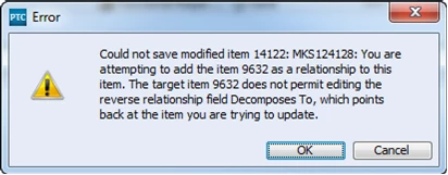

Error during create "decompose to" trace
when I create a "decompose to" trace between an input and requirement document, I receive an error message (see attachement
14122= requirement, 9632=input).
A decompose trace between two requirement documents or between two Input documents works.
Can you give me some helpful hints, where I can find the problem?
thx
Bernd
    blercherAnswer
    Problem solved, it was a editability rule in the decompose to field
