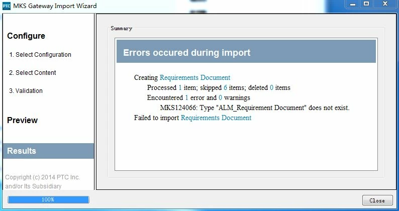

Error MKS124066: Type "ALM_Requirement Document" does not exist. what reason?
It had happened when I imported a reqiurement document (Integrity v10.6).
Thanks!

    Hi Roy,
    can you check whats the correct name for your Requirement Document type inside your Integrity Admin? Perhaps without Prefix?
    Then, check the file gateway-tool-config.xml located in your client (or gateway server directory) if this name (with prefix ALM_) is there. Then, adapt the names to match to what you have in your Integrity Admin.
    Does this help?

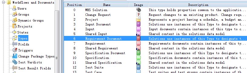

    Hello, Volker
    Thanks! I checked  my Requirement Document type inside your Integrity Admin as following:
    Is it without Prefix?  How do I modify it?
    and I searched "ALM_Requirement" in gateway-tool-configuration.xml file,  but no found anything.
    Thanks!

    Roy,
    Ok, hm, can you please tell me which Import configuration you choose?
    And, is it right that you import a word document  (docx)?
