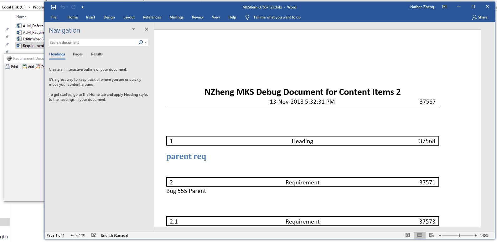

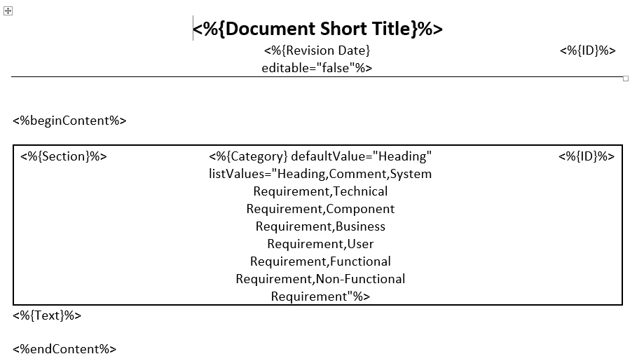

Dec 10, 2018 10:02 PM UTC
Thanks! I found that in the directory you mentioned. So I made an example .dotx template in there (attached screenshot), and configured the Requirement Document to use that template.
So I was able to open the Word editor by going Item --> Edit Item in Word --> Entire Document. See screenshot attached. However, unlike the video I see here, when I close Word, I don't see an option to publish the change. Is there something I'm doing wrong? (I found the document title in Word a little weird as it says it's still a .dotx document instead of a .docx)
Dec 11, 2018 7:11 PM UTC
Your template looks fine.  I just checked on my system doing the same thing.  The Publish pop-up only shows when you've edited content - if you make no changes, then the document just closes.
If you're still seeing no publish after changing content, then I'm not sure what's going on. I see you've already opened a case with PTC Support to investigate.
