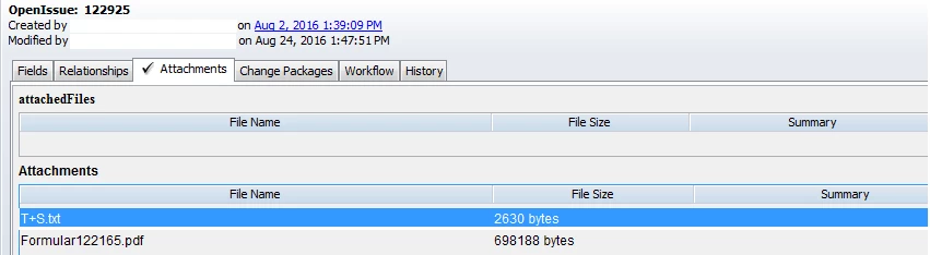

Fetch attachments of file names having a + character, using SoapUI
I am trying to fetch attached files from Integrity 10.6 server using  soap requests.
I tested SoapUI 5.2.1  from SmartBear
Our Integrity web service  location looks something like http://server:port/webservices/10/2/Integrity/
But whenever the filename contains a + character, the downloaded size is 0 (see also below in red colour what SoapUI responds)
Example of file names having this problem:
T+S.txt
Moto+S.docx
I tried both text files  and binary files
For other attached file names, without a + character in their names, I can successfully download the files, without problems.
(e.g. ABC.pdf or SomeImage.png)
The request in SoapUI looks like this for  T+S.txt

    Hi Alexandru,
    Unfortunately, this is an identified defect, SPR # 5345732.
    Here is the knowledge article related to it:
    https://support.ptc.com/appserver/cs/view/solution.jsp?n=CS209386
    If you want to be attached to the SPR, open a case with Support, and they can do this for you.
