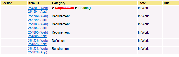

Hello, i want to change the report style of a document. It's possible to compare two document versionw of different dates to see the executed changes. The HTML output report shows the whole document included the changes made between these dates. The variation is colored green. I only want to have all changed fields but not the complete document. Do somebody know how i can realise it? I tried queries and different report styles but unfortunately with no succes.
In this example, the right picture should just show the first row not the unchanged fields, too.
Thank you for answers

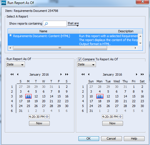

    Jan 12, 2016 7:21 AM UTC
    Hi Mart,
    as far as I understand, you want to the detailed differences for a single node, right?
    The General Approach on differnce Reports is:
    1. design a report recipe, containing your fields of interest and create a Report for that recipe
    2. Menu > Item > Historical > Run Report as of...
    3. Choose your new Report and two dates
    4. Integrity will create a Report that contains the known RED/GREEN highlighting only for the fields that changed.
    HTH Matthias

    Unfortunately i want the differences of the complete document not just the single node. So the HTML output should just show the changes of the document between two dates. The unchanged fields should not appear. I tried your method with different reports but unfortunately the unchanged fields appear, too. Do you know another approach maybe?

    Hello Mart,
    i've worked with reports before and have to agree with Matthias an Kael. One way would be to use Javascript inside your report recipe.
    I had a quick lock at a report and i am not sure how to best identify the content you want to keep. You could maybe check if the triangle image is in a line and if not (no historical changes) hide that line. But this way, the content would still be inside the report, only hidden. You could also try removing content with javascript but the results depend on what you want to do with the generated report. Especially IE is hard to work with if you want to save your report.
    If you want to check the content before written it to the document, you could use a jsp (java server page) utilizing the api. But building this solution would be much more elaborate.
