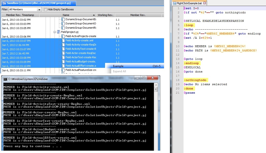

Hi to all,
I use Integrity Client 10 and would like to be able to get in a programmaticall way, the selected member informations (like name, path in the sandbox etc)
on each click done on a member in the client GUI.
I know that this is possible but I am not sure how to get the event "onClick" on the member in sandbox view.
The documentation for MKS Integrity 2010CLI Reference Guide does not help in this regards.
Please advise,
Adrian

    I think I know what you're asking, and I hope this example helps you get started.

    Oct 28, 2013 9:04 AM UTC
    Thank you for your respone. Unfortunately, it seems, that the environment variables are not set at all.
    I mean the ones starting with MKSSI_. I have the client started and I cannot print any of the variables as there are no variables set for them.
    Is there maybe an option to activate the environment variables?
    Thx,
    Adrian
