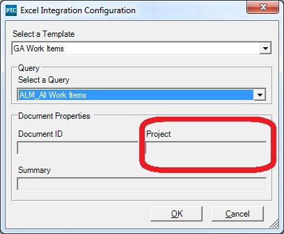

I want to create a mapping configuration for the Excel integration that will give me all of the work items in a project. I want to be able to specify the project in the dialog in Excel.
How do I go about doing this? I can't figure out how to enable that Project field.

    That entry box is greyed out, because you're using a query, and the current design assumes you will specify in your query, which project(s) to query against.

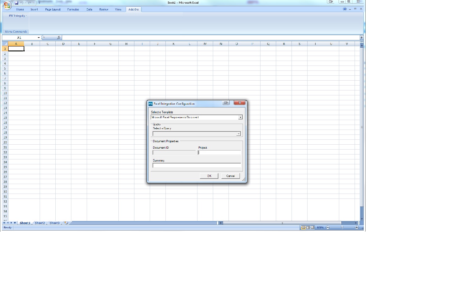

    The box does become active for data entry, if you are invoking this dialog through another means, where you aren't using a query, but creating a new list, for example.  (see my attached screenshot below)

    But how do I define it in the mapping template?
    Below is what I have so far. Also, the server doesn't seem to be willing to use the updated file. It's still using an older version that I uploaded last night.
