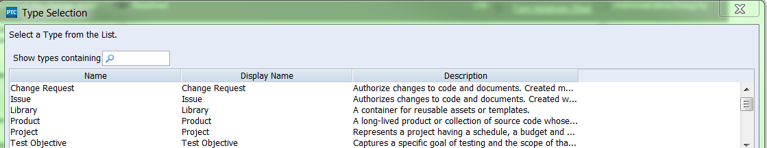

Hi, Is there a way to sort the items displayed in "Type Selection" window displayed when creating new item using Item>Create option?
See below snapshot

In the admin client try selecting the types list and in the window right click and select reposition types.  Ensure the ones you want listed first are at the top and so on down the list.  How they are positioned in the admin tool is how they will show up in the create menu.

To be more precise, this is valid only for the Integrity client.
The web interface sorts alphabetically no matter what.

Thank you very much Lance. Appreciate your response. Repositioning the types in Admin Client helped in positioning the types in the "Type Selection" window
