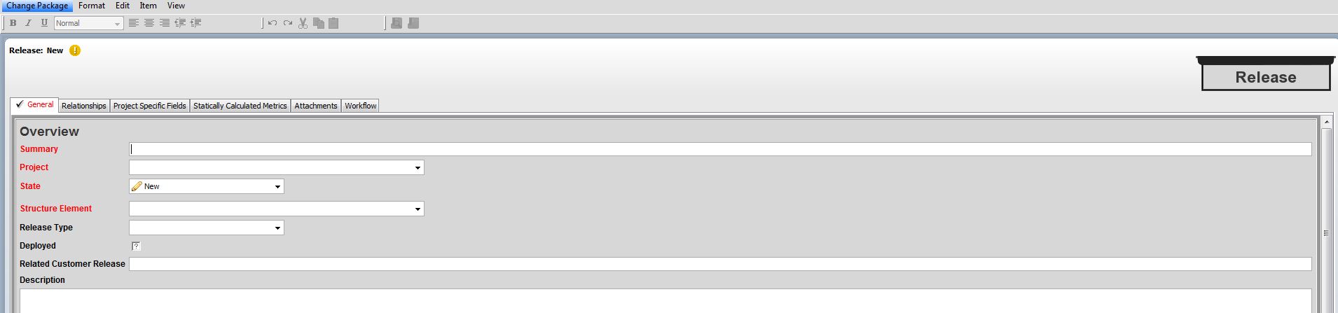

Hi, Kindly support me to create realization order from release type id
Release id:
ReleaseID.JPG++
In this release id, I want to create Realization order under "Outgoing" via CLI

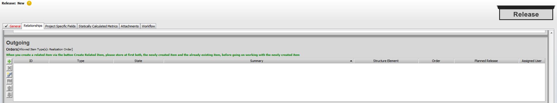

Hello Dhineshkumar,
if I understand your request right, you like to automate the creation of related item(s) when you save the base item.
This operation can be done by triggers only, but is a common requirement.
I would suggest to take a look at the standard relationship trigger: "Post and Maintain Related Issue"
You can find it in the Rule Tab within Relationship fields.
Here is the explanation: Post a linked item. When an item enters state A, if the boolean field B is set to true, then post a new item. The newly posted item will be of type C. Optionally, append to the field to indicate that this new item was automatically created.  Example: When a defect is fixed, if there are required documentation changes, then automatically cause a documentation item to be posted, linked back to this item.
Is this what you are looking for?
Volker
