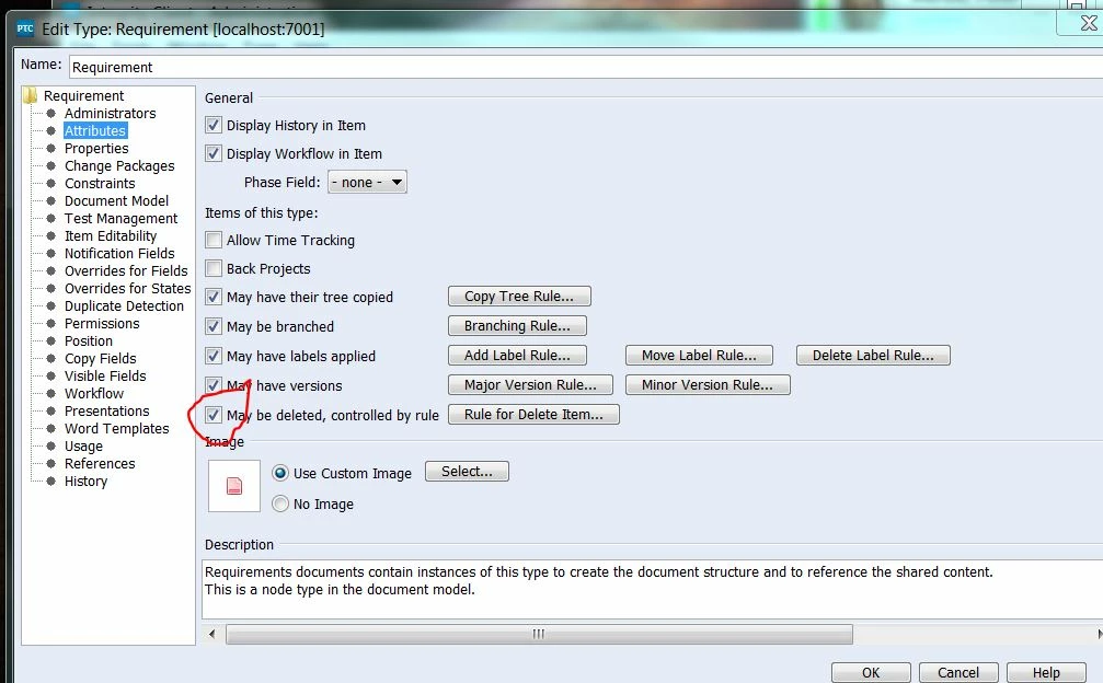

I attempted to delete a requirement but then received a message stating that I needed to change the "deletion allowed" field.
    March 10, 2015
    In the Admin Client edit the type "Requirement" and enable the check box "May be deleted, controlled by the rule" (see attachment),
    The rule can simply remain empty.
