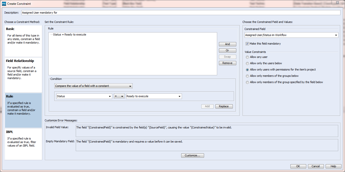

    Aug 4, 2016 8:45 AM UTC
    From my perspective the easiest way is to use functionality  "Constraint" within the Type definition.
    There you only need to set a rule definition like this:
