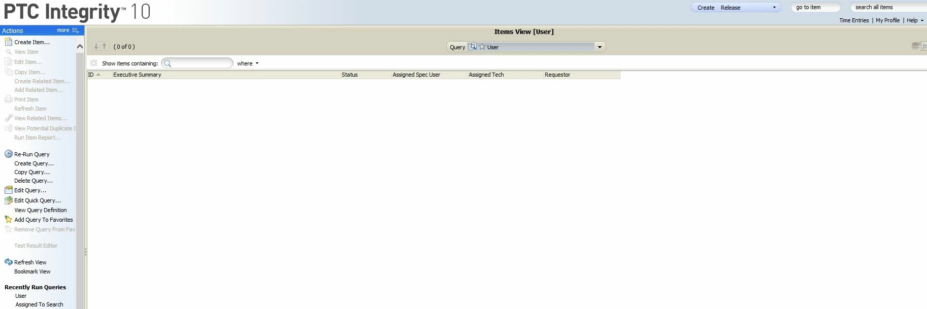

How do I search for an object within change packages?
I can search all requests for a particular object but....
I'd like to narrow my search to be only in change packages that are found in individual requests. I may have an object called OBJECT1 that is only listed within a change package and not listed anywhere else. So, when I get a production report indicating that OBJECT1 was changed, I want to be able to search Integrity and find it.
Ideas? Help?

    tmiller-31-VisitorAuthor
    Mar 1, 2016 2:51 PM UTC
    Thanks for the awesome response and it does look like something that would be helpful. The question is "How do I get that screen?" Where can it be found?
    I have attached a quick pic of my PTC opening page.
    Mar 1, 2016 3:06 PM UTC
    Oh thats a good point.
    I don't use the webclient very often. And it seems like there is no possibility for change package operations like find.
    Do you have a chance to use a normal client?
    there it is very easy to find:
    Change Package -> Find
