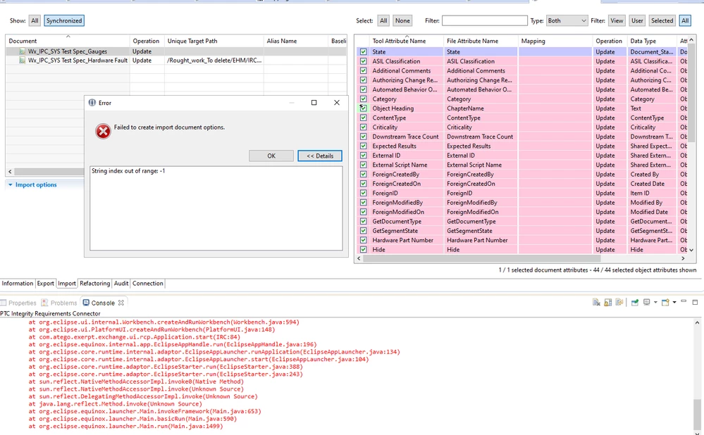

Hello Vladimir,
Thanks for the information and sorry for the delay to response. I had some issues with the IRC license. I followed the instructions from the second bullet (Modifying DOORS import options", however I am getting an error when clicking on the Target Path as you can see in the following image:
Do you know if I could be missing something? I am just trying to change the Target Path of a document that I had previously imported (using other roundtrip). Now, in a new roundtrip I have such document (which appears with the update operation as it was imported previously) which I need to update but need to put it in a different path.

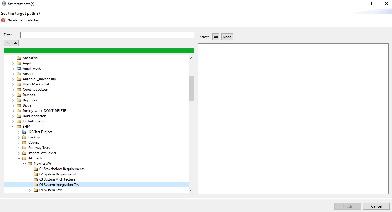

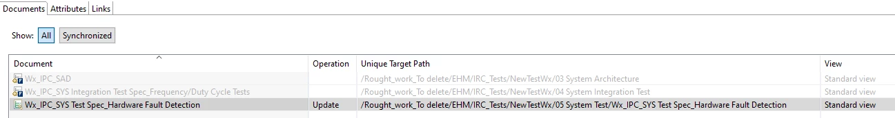

Oct 8, 2024 11:22 PM UTC
Here are other imported documents, those are not showing a Target Path:
But if I try to specify one, It does not allow me to do it, the Finish button is grayed out>
