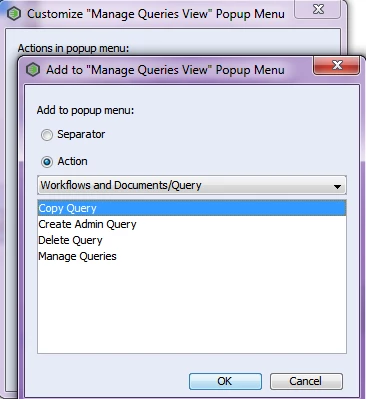

The "Copy" action copies the text selected to the clipboard. There's a different action called Copy Query. If you don't see it, you can customize your right-click menu:

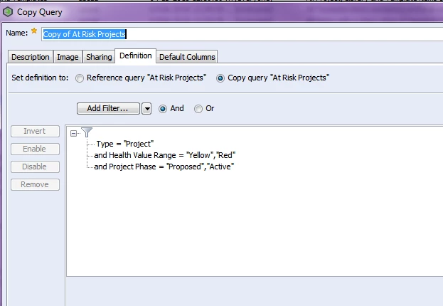

When you select this option, a Copy Query window will pop-up with the filters of the query you are copying. You can then add or remove filters and change the name:
