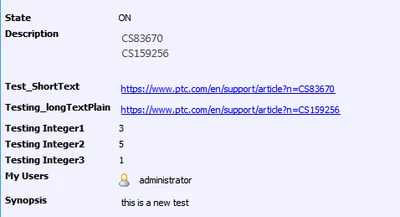

For a short text field or a long plain text field, then the URL is made a link automatically when viewing the item in GUI or Web.  I tested with your script on my system (using a different URL), and here's what I saw after saving the item:
What version are you using? I can test with that version as well.

Here's the code I used. I only added a couple print lines and changed the URL and the field name. I've run it on 12.0 and 11.2 CPS01
var eb = bsf.lookupBean("siEnvironmentBean");
var delta = bsf.lookupBean("imIssueDeltaBean");
eb.setMessageCategory("TRIGGERSCRIPT");
var value = delta.getNewFieldValue("Test_ShortText"); // pull value from field called "Testing for trigger"
eb.print("Value for field is: " + value);
 if (value != null) // Run when the field is not empty
		var va = "https://www.ptc.com/en/support/article?n=" + value; // adds the field value to the end of the line
		eb.print("New Value for field is: " + va);
		delta.setFieldValue("Test_ShortText",va); // send the value of va back to the field "Testing for trigger"
