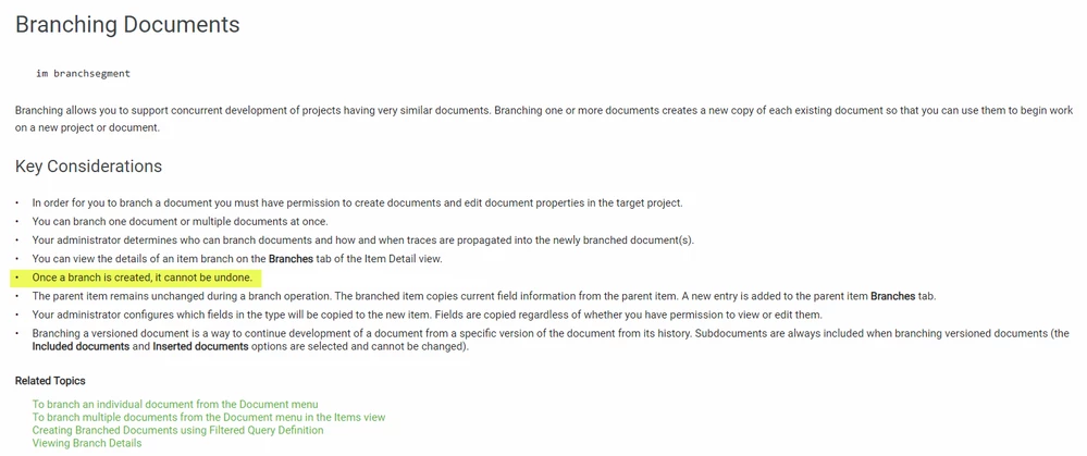

How to delete/brake the "Branch Information" between documents?
Is it possible to delete (or brake) the branch Information between documents?
For example I have document A and create a branch document B.
Now I have the Information in document B, that document A is the root document.
How can I delete the root document Information in document B?

    to break the branch, you will need to toggle the item from Shared to Reuse and edit one of the "Significant Edit Fields" of that item type

    Take a look at the following: (Branching Documents (ptc.com))
    This may be the answer (which you did not want...).
