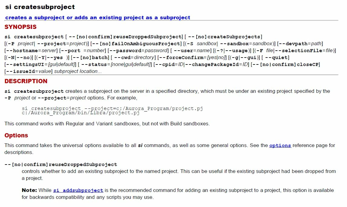

    Use the command
    si createsubproject --noreuseDroppedSubproject
    (see also attachment).

    Hi, Peter, and thank you for your answer. I tried with --noreuseDroppedSubproject and I get the following error message:
    Creating subproject...
    folder2/project.pj
    folder2/project.pj is not added, since it exists in the server filesystem.
    This is exactly what I'm trying to avoid: PTC looking in its server filesystem. I just want PTC to treat all subprojects as new subprojects even though they were added and dropped on previous operations.
