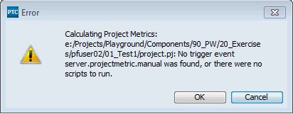

    Sep 26, 2016 5:11 PM UTC
    Trying to run the suggested solution I get the following error:
    In our installation I haven't found such a manuel.
    How to solve this problem?
