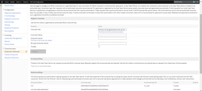

You need to set these values by configuring DOORS Next. Some instructions below that I used in the past, and a link to the IBM Help page.
IBM Help page
  1. Register an OSLC Consumer (Inbound) for use with Modeler
  2. Refer to the Help page and complete steps 1-5.
  3. Using the menu in the top left of the app, under Administration select Jazz Team Server Home
  4. Select Server > Consumers (Inbound) and follow the instructions in the Help above.
  5. Set the values for
  • Consumer Key:
  • Consumer Name:
  • Consumer Secret:
  1. Select the Trusted checkbox and click Register.

AarushiS12-AmethystAuthor
Apr 8, 2024 2:43 PM UTC
Hi Patrick,
Thank you for the information, will surely try this out. I just had one doubt that while installing DNG on Jazz Team Server, we have default value of Consumer Key and Consumer Secret already registered and present under the Authorized Keys section of the OAuth Consumer page. So, my query is can we edit the Consumer Secret value of the already registered Consumer Key under the Authorized Key section? If yes, then maybe I need not register another consumer. If no, then do I need to register another consumer?
I am adding the DNG layout below for more clarity.
Let me know if you need any clarity!
Aarushi
