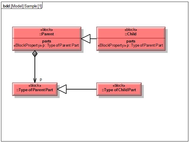

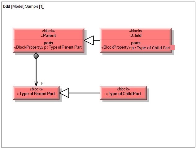

I have a concern with inherited part properties in Integrity Modeler using SysML. I'am not able to change the type of an inherited part property (without changing the type in the "parent-element" as well). Any ideas?
Here is a simplified example:
So far the following blocks and relations have been modeled:
Now I wish to redefine the type of the part property "p" of "Child". It should be in the end like this:
Comment: I did this before in Cameo Systems modeler. The procedure there was:
  • right click on "p" of "Child"
  • "refactor"
  • "redefine to..."
  • A list of possible types apeared - in this case [Type of Parent Part; Type of Child Part] - and I would choose "Type of Child Part"

I have this working by selecting the inherited (virtual redefinition) part in the parts browser and then updating its text description property. The converts it to a real redefinition, which you can find in the package browser.

Hi gmoeser,
I ran into the same issue, but meanwhile I got help... And it works 😉
The point is the distinction between virtual redefinition (VR) and real redefinition (RR). In your diagram the Child block is probably still a virtual redefinition, which means that with right-click on Child.p > Set you get only Type ... which would change the type of p in the Parent.
Thus you have to turn the VR into a RR. You can do this by simply writing something into the description field of Child.p and leaving the field. Doing this, all of a sudden, in the package browser p appears as a block property below Child, as it turned a RR.
Repeating the procedure above you get more options. Now you can choose right-click on Child.p > Set > Type (Redefinition only)... and in the dialog window select the TypeOfParentPart's sub-type TypeOfChildPart.
This should have done the trick and result in what you wanted, I guess.
For more info have a look at the help under Redefinitions of SysML items (SysML)

Hi Georg,
interesting effect...
As absurd as it might seem: It does not help, if you do this on the bdd by selecting the child.p and writing something into the description.
You need to open a ibd of child, populate it with child.p and then write something into description (maybe only adding a space to the stuff that you already wrote). When you now leave description you will see, that in the package browser below child suddenly the block property p occurs (which is the sign, that the VR turned into a RR).
Now you can do as already described above and it should work (at least it worked here):
