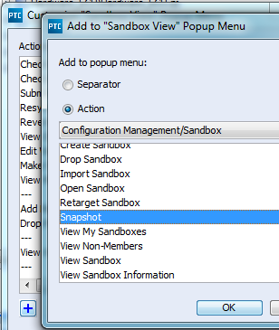

    Aug 12, 2016 4:18 AM UTC
    Hello Pashan None‌,
    I think its "invisible" in your viewset. You could make it visible by selecting "Viewset ==> Customize ==> Actions ==> Configuration Management ==> Sandbox" and make "Snapshot" as visible. If not just select the require sandbox sub project, right click and choose "Customize This Menu" and click on "+" button at bottom and select "Sandox" from Action dropdown and choose "Snapshot".
    Sathish
