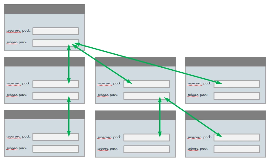

we have an item-type which is representing a hierarchical structure of release artifacts (function-packages). If we are developing new functions, then these functions can be splitted into packages, and the packages can also hold other packages (and so on) until we come to the smallest development artifact (a module).
In integrity we have built an item-type "package" which is holding both sides of a relationship field. The forward direction of this relationship field is named "subordinated packages" and the backward direction is named "superordinated packages". So in each package the users can see, which other packages are holding the package which the user is viewing and which other packages this package contains.
There are also some triggers which are reacting if the hierarchy is changing. So as example the item type is containing date-fields (for planned release dates), which will be inherited in each subordinated item by such triggers.
Now to my problem: if i have an existing hierarchy of 3 packages: package A at the top, package B in the middle and package C at the bottom, and i want to put a fourth package D as a subordinated package into package B i can do this by editing the relationship field in two ways.
The "downstream-way": i am editing the forward-part of the rel-field in package B and add package D into this field.
The "upstream-way": i am editing the backward-part of the rel-field in package D and add package B to this field.

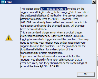

Both actions are triggering the above mentioned inheritance, but only the downstream-way is working. If we are trying to use the upstream-way, the trigger is starting in the superordinated package B and if it comes to its own subordinated packages, it will try to modify the date-field in the subordinated package D, which is already modified. So we are running into an cyclical trigger error (see the attached screenshot)

added a scheme of the mentioned hierarchy...

thanks for your idea, but this doesn't work. If an user tries to edit the relationship (at the side where it is allowed), after clicking apply he will get the error message:
"MKS124128: You are attempting to add the item 12345 as a relationship to this item. The target item 12345 does not permit editing the reverse relationship field <name of the relationship field>, which points back at the item you are trying to update."
