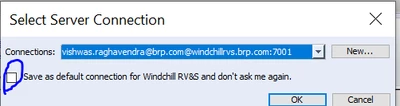

We have 3 servers, Dev, QA & Production in Winchill RV&S and the client preferences are by default set to production environment.
If a user selects save the environment as default, there are no options in RV&S to switch to a different server.
Can somebody help to understand if there is any other way?

But for some user who have  aved one server as a default server are unable to find options to switch to another server.
I have added the picture below for reference.
In this case, where can i find an option to switch to another server

Go to File > Preferences and select "Prompt for Host Name and Port when connecting".
There are four places where you can do that, under the four main rubrics of the Preferences dialog. Test to see which ones you need based on usage.
Remember that each open tab in a viewset remembers its connection. So once you have your preferences set, you need to use a "Item > View Items", or "Project > View Projects" etc. to open a new tab.
Better yet, you can configure different viewsets with different tabs connected to different servers, and then never have to be prompted again. In my case, because I'm administrator of the system, I have one viewset specifically for development work.
Oct 3, 2023 6:14 PM UTC
Please tell them to follow the steps I explained above: They have to use File > Preferences and the Connection options to enable being prompted.
The "Save as default" in the example you showed is what unchecks the options in the dialog. You re-establish them via File > Preferences.
