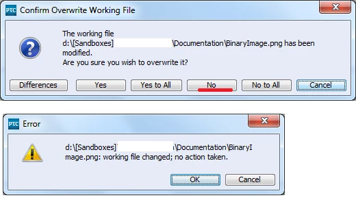

    I have tested  your scenario with a binary PNG file .
    When I check out the file I get a warning message box. Please see the attached screen captures.

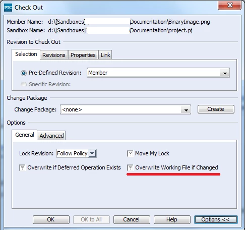

    Please verify your Check Out operation preferences
    Follow from the menu  File->Preferences->Configuration Management - > Commands -> Check Out
    On my computer I have
    - an "On conflicts"  dropdown list which is set to "Confirm" .
    - a checkbox with a question mark "[?] Overwrite working file if changed"
    For this reason  when I actually perform the Check Out operation I can see in the "Options>>" section.
    the  "[?] Overwrite working file if changed" checkbox set with a question mark
    I assume this is why the PTC Integrity Client asks before overwriting my image.

    On binary files,
    the checkout refuses to apply the LOCK to the member whenever I try to keep the local changes in the sandbox (the working file is modified).
    Thus I can not use the checkout command when I have already modified the binary file.

    What is the intention of the setting:
    Revision to checkout --> Pre-Defined-Revision: Working
    I thought this would mean that I "checkout" the current working file, thus keeping potential local changes and apply the LOCK.
    But it looks like this setting does the same as when selection "Member".
    On my computer  when I actually perform the Check Out operation, I have
    Revision to checkout --> (*) Pre-Defined-Revision:  Member option selected in the dropdown list
