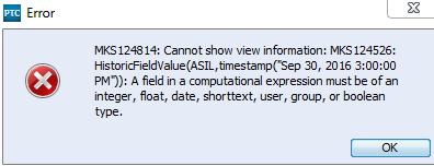

Currently the error message is as follows:

    do you have a field defined in Admin with computation "HistoricFieldValue"?
    And you like to present the ASIL name instead of the number?
    in this case I would expand the calculation as follows:
    (HistoricFieldValue(...)==0?"QM": (HistoricFieldValue(...)==1?"A": (HistoricFieldValue(...)==2?"B": (HistoricFieldValue(...)==3?"C":"D").
    Return type will be string.
    Is this what you are looking for?
