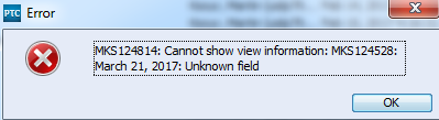

In my js script I'm trying to use it in this manner:
<%compute%>HistoricFieldValue("Content","March 21, 2017")<%endcompute%>
Normally it should work , but I think the problem is the date. What is a timestampconstant?
This Error message pops up

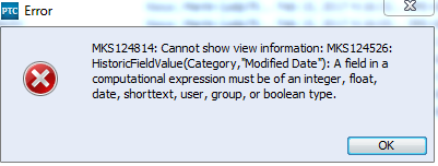

When i change it to
<%compute%>HistoricFieldValue("Content","Modified Date")<%endcompute%>
(This usage is senseless actually, but I want to describe the problem more precisely )
This error message occurs:
I hope somebody could help me how to use this HistoricFieldValue Function

Mar 22, 2017 5:37 PM UTC
Hi Martin,
You may want to open a Support case for assistance with this, but try the following format for timestamp-constant:
MMM d, YYYY HH:MM:SS [e.g. timestamp("Jul 25, 2014 6:18:36")]

Mar 23, 2017 11:39 AM UTC
Hi Michael,
yes, this is it.
timestamp("Jul 25, 2014 01:00:00 PM")
THX for your help, i really appreciate it.
