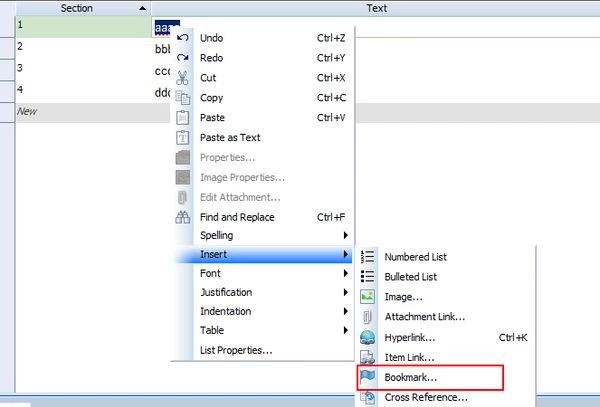

    Hi Dbarry,
    Bookmark can be used with Cross-reference. Similar to Word bookmark.
    1.) Insert a bookmark

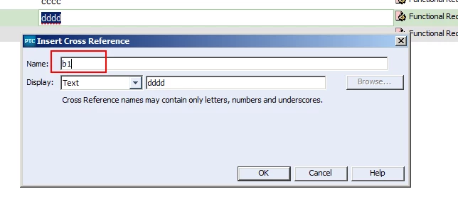

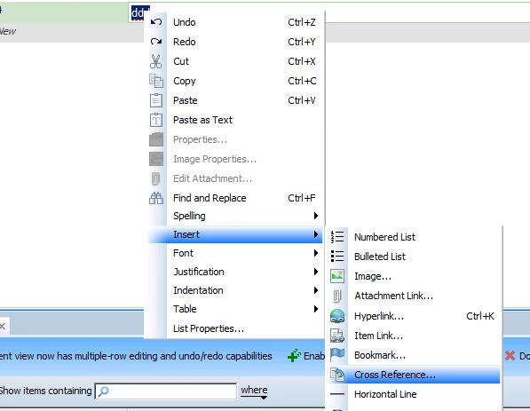

    2.)Then insert a Cross Reference for another text, the name should be the bookmark name

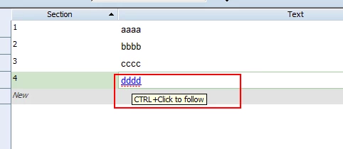

    3.) Now if you press Ctrl and click on the text, the cursor will switch to the bookmark text.
    Hope This Helps. Please let me know about the same...
