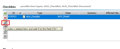

Hello all,
while trying to create an ALM checklist with the below command I am getting an error. I would appreciate if you could propose a solution for this:
C:\Users\kusuo>im copyissue --type=ALM_Checklist --addFieldValues="ALM_Template=3006228" 5875610
Creating ALM_Checklist ...
Adding field values ...
Submitting ...
Could not save item: An error occurred while executing a remote method call; nested exception is:
java.lang.AssertionError: Unknown fva rel: class mks.util.IntSet
Target is to link this checklist to a review later on. On the GUI, a linked checklist is created through the create a related item link:

Hi @ozgur
By this small screenshot it's difficult to understand the problem. Still quick question:-
1.) In your command, What is the type of the field ALM_Template?
2.) What is this value 3006228? An another item ID? Which item?
3.) From where you are copying item ID 5875610, What is the type of this item?
ozgur1-VisitorAuthor
Feb 21, 2022 10:14 AM UTC
Hi kjain2,
1) ALM_Template is a "pick field"
2) 3006228 is a PTC checklist template item.
3) 5875610 is a PTC review item.
I noticed that when I use the "Review PTC item" with the option --linkToField="ALM_Checklits" then it works!:
im copyissue --type="ALM_Checklist" --addFieldValues="ALM_Template=" 3006228 --linkToField="ALM_Checklists" 5875610
However, I'm still getting the same error but PTC seems to be creating a new checklist based on the checklist template and link it to the target review. I guess I can live with that!
