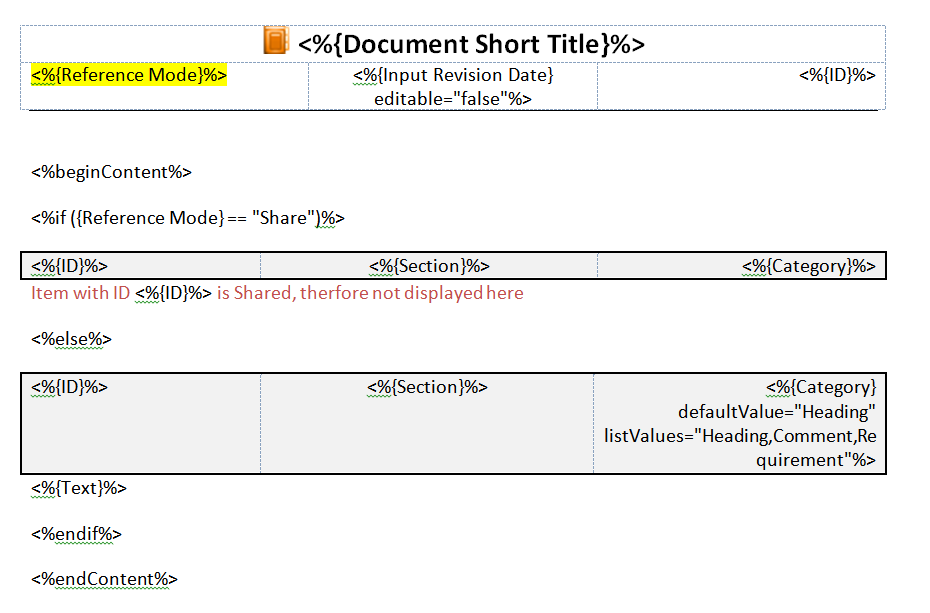

May 5, 2017 2:02 PM UTC
Hello Volker,
Thank you for your help.
Unfortunately, it does not work. Because when I add the Where clause, the Edit In Word view is not filtered (I can see the Share Reference Mode Contents). Moreover, the whole of the document is in read only mode.
Does it mean I need a configuration in order to allow the filter to be applied in the Edit In Word?
May 5, 2017 5:50 PM UTC
Hi Frederic,
The layout that I had in mind was this:
Important is to have the Reference Mode as a normal field somewhere, otherwiese the value is not mapped.
You can put it wherever you want, also in White color is fine.
Otherwise the IF statement can not recognize the field.
Hope this helps
