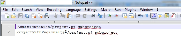

    And surprisingly it seems to work in another situation too, when enumerating the members of a project (which can be subprojects too, not just file members)
    And for subproject names I see that it is allowed to use characters from other code pages than 1252, for example I can choose characters from windows 1250 too.
    For example this is a valid subproject name: t:/SomeProject/RegionalțĂȚ/project.pj
    (see the attached file screen captures)
    So this command works too, I can correctly read the accented characters of the subproject names
    chcp 1250
    si viewproject --hostname=SomeHost --port=101 --project="t:/SomeProject/project.pj" --norecurse  >members.txt
