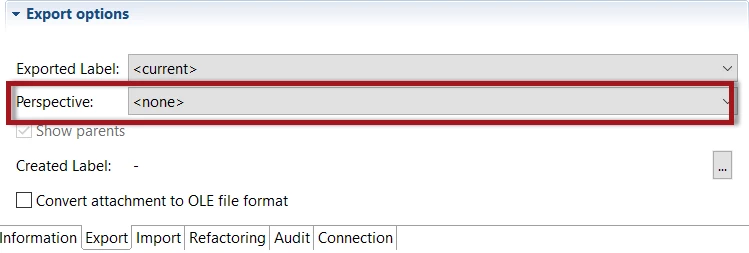

This question is related to how to use "Perspective" of IRC 3.2 features.
I am currently using ILM 10.6 client /server and IRC 3.2.
In ILM 10.9, I know that the perspective is available in the Document View.
Is there any way to do this in 10.6?
The reason I need this feature is that when I export a document using IRC, I want to export only specific contents that is filtered in the Document View.
Please help me..
Thank you.
Dec 8, 2017 9:20 AM UTC
Why not considering an upgrade to 10.9, or better 11.1?
Dec 13, 2017 4:54 PM UTC
As veckardt makes the point, in his question, there really is no way to do this without an ILM upgrade, as the Integrity "document perspectives" were not a feature until the 10.9 ILM release.
