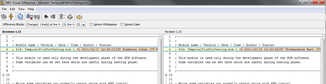

vravi1-VisitorAuthor
Feb 22, 2017 5:25 AM UTC
Hi Mr.Klaus Thierer,
   Yes, It is possible to use the command si diff -g -r 1.31 -r 1.33 "TemporalFileForTesting.bcm".  It shows the difference in MKS Visual Difference Tool which I don't want to have as I run all the SI commands in Batch mode. Hence I want the difference in file to be captured in a variable.
Mar 2, 2017 12:01 PM UTC
For me it seems that 'si diff' in this context expects an external tool that can be called by 'diff'.
That mean it will call the first executable it finds within the search paths of the Path-Variable
that matches the pattern (diff.exe/bat)
You could try to mimic what 'si diff' does with the following approach
>si projectco --nolock -r 1.31 --targetFile=.PTCTMP\1.31@TemporalFileForTesting.bcm TemporalFileForTesting.bcm
>si projectco --nolock -r 1.32 --targetFile=.PTCTMP\1.32@TemporalFileForTesting.bcm TemporalFileForTesting.bcm
>your_diff_tool .PTCTMP\1.31@TemporalFileForTesting.bcm .PTCTMP\1.32@TemporalFileForTesting.bcm
You would still have to install/download an own diff tool though (maybe something from the GNU collection).
Or the dirty way
diff.bat (at best in the first directory of the path variable)
REM show the command line that 'si diff ...' generated
echo CMD: %0 %*
REM call the command with parameters (%*)
"c:\my_local_copy_of_Toolkit\mksnt\diff.exe" %*
In the end I would say just install that toolkit, and if you dont like what Toolkit does to your system Variables (path ...)
just delete all Toolkit specific, and prepend the directory ...\Toolkit\mksnt to the path variable in your batch file or command windows.
BTW:
I don't know if there is somewhere but,
I feel that for command line users there should exist a recommandation that the directory ...\Toolkit\mksnt should be the very first entry of the (system) path variable.
Regards Jürgen
