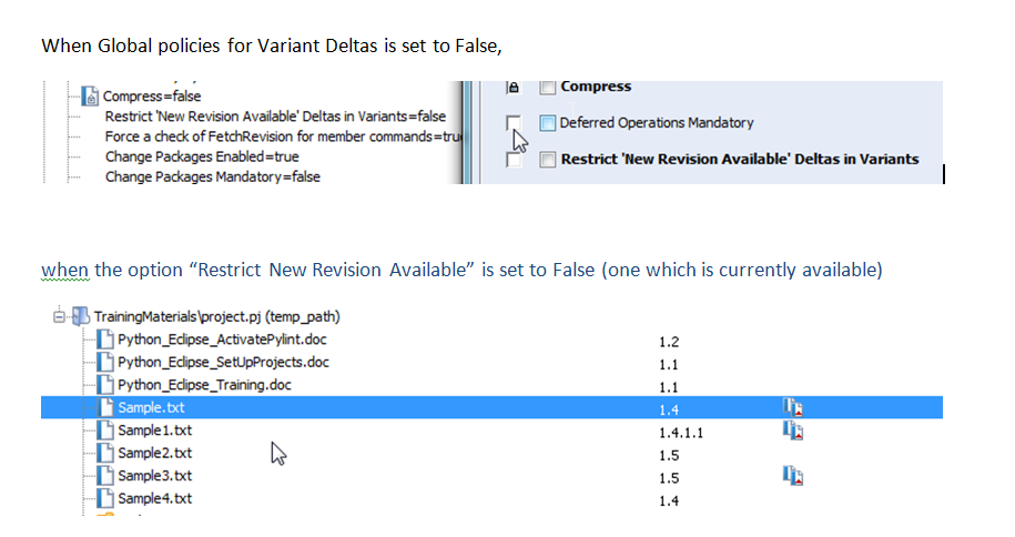

Is there a way find out if the members on a devpath do not have the latest versions as their member revision ?
trunk tips are not matching the member revision ???

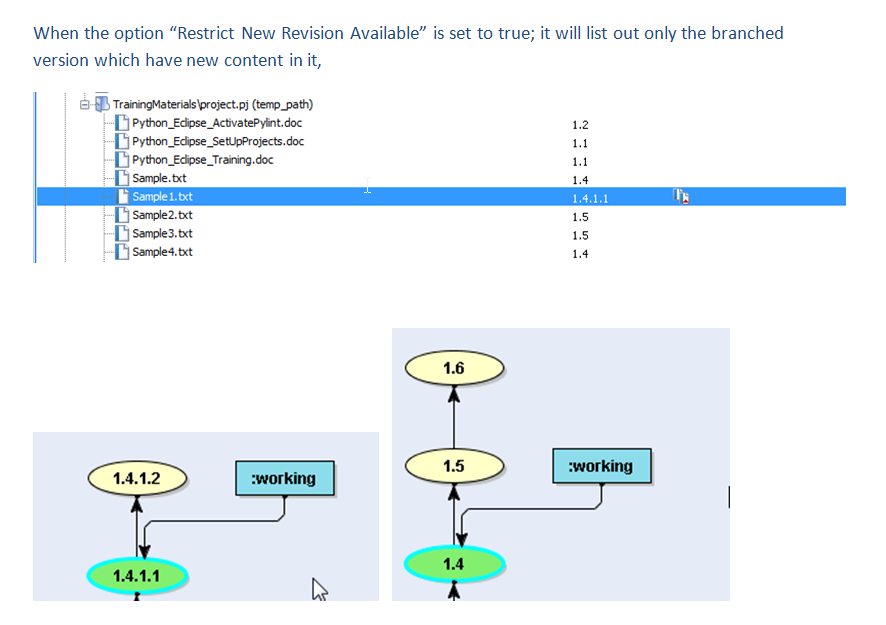

    Hell Hector Magnanao‌,
    This could be achieved by making "Restrict New Revision Available" to True in Policies for Configuration Manager Admin client.
    I hope this is what intended?

    Hi Sathish,
    I was looking more for a query or a CLI that would list out the files that has a new tip revision but not the member revision.
    Hector
    hmagnanao1-VisitorAuthor
    Feb 15, 2017 4:04 PM UTC
    On a specific devpath.
