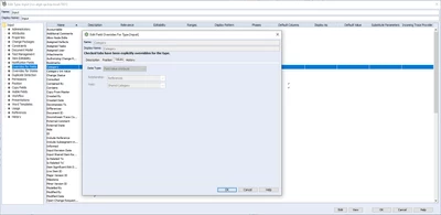

Hello all,
We've come across fields without an "Editability" Tab, where we need to lock the field's editability dependend on the item's state. How do we do that?
In our system there is a field "Category" with the type "fva" where the Relationship is "References" and the Field is "Shared Category". The field "Shared Category" is from type "pick".
This field "Category" is visible on an Item "Input". What I want to achieve is that if the "Input" item is in State "Released", the field "Category" shall not be editable.
Normally, within the "Input" Type I can override the editability for a field within the "Editability" tab... but it is missing?!
Why is it missing and how do I accomplish that it is read-only dependent on the item's state?
Thanks and kind regards,
Michael

This field is part of the "document model" and PTC decided many years ago to remove editability and relevance rules for such fields. It doesn't make any sense to me, my guess is that they thought they would prevent users from making mistakes.
In any case, I too have searched and searched for a solution and cannot find one. Except using a trigger to block such edits, but that's ugly of course.
My own solution at this point is to let my users make mistakes. I wonder if you could create your own Category/Shared Category field combination and hide the other one away (you can't remove it), but I don't have time to test that.
I'm curious too and I'd like to know if someone has come up with a solution.

We have not come across an answer why specific "built-in" fields do not have an editability tab yet. We have implemented a trigger for such fields which prevents any user edits.

I've played around with the 2 properties "MKS.RQ.Editability.1" and "MKS.RQ.Editability.Document.1" because naturally, from the description of the properties they should accomplish exactly what we wanted. The problem was, that the edibaility of a field if blocked by "Allow Edits" or a Custom Computed Field is only locked in the inline editor (if you edit a node within a segment). As soon as you open the node within a seperate editor (STRG + E or Right-Click -> Edit Item...) you can edit any fields regardless of any MKS Property.
Thanks for your comments on the trigger. I have already implemented one. Obviously, he is neither long nor complicated, but a trigger is always the worst user experience and we try to avoid them as much as possible.
