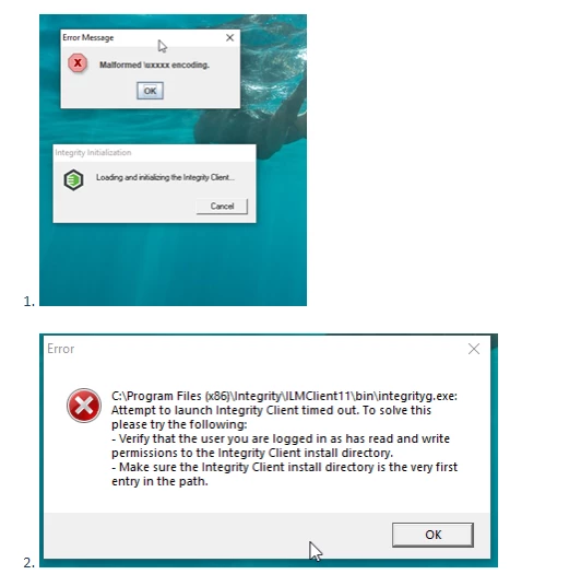

Hello everyone,
I am facing an issue with PTC integrity. Whenever I start the PTC, I get the following errors.
'Malformed\uxxxx encoding'
Afterwards PTC integrity never opens. Could you please help me in resolving this?

Hi @Shanmu ,
Before i go into the detail or make any guess i would suggest you to mainly check couple of things:-
1./ Ensure your Environment variable is set mainly %PATH% &%MKS_IC_INSTANCE_DIR%
2./ Make sure you have read and write access to directory where %MKS_IC_INSTANCE_DIR% is pointed to otherwise choose an directory where you have an access.
3./ Close the Integrity client if running, please also check from Task Manager to be sure that it's not even running in background. Then backup and delete the following files/folders from %HOME%: .mks, IntegrityClient.rc, ICServicePack (Note: Client preferences, viewsets and sandboxes will be temporarily gone with this test if you have any) and restart the client.
And this is very good article to follow as already suggested :-
Article - CS123559 - Integrity Lifecycle Manager Client will not start on Windows (ptc.com)
Does this help?

This knowledge article goes through the usual troubleshooting steps, to resolve this Integrity client start/timeout issue:
https://www.ptc.com/en/support/article/CS123559

May 2, 2023 5:47 AM UTC
Just to add, Issue was resolved by removing only IntegrityClient.rc file for one of my user.
Rather than reinstallation, if anyone facing the issue, just try this solution.
Jan 23, 2025 8:31 AM UTC
This worked perfectly. Thanks a lot.
