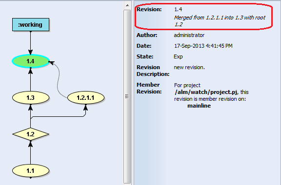

Hi @all,
it feels a little bit like this would be a stupid question, but i didnt find the answer in the documentation: If i merge a member from one member-branch to another, shouldnt there be a sign to see quickly which member was merged with which other member? If the merging process in in progress, there is a path from one branch to another visible in the member history. But if the merge-process is finished, there isnt. Am i doing something wrong or is this actually the way how it works?
kind regards, Jens
September 26, 2013
You can see the merge information for a revision by looking at the member history or the revision information. Highlight the member in your sandbox, the select Member > Views > View History. You should see the merge line in the history, and if you highlight the revision created from a merge, you will see the merge information:

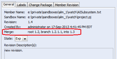

Similarly, if you look at the revision information (either from the member history or sandbox view, by selecting Member > Revision > View Information), you will see the merge information as well:
There isn't any visible sign in your sandbox or project that shows if a member has been merged. It only shows on the revision information.
