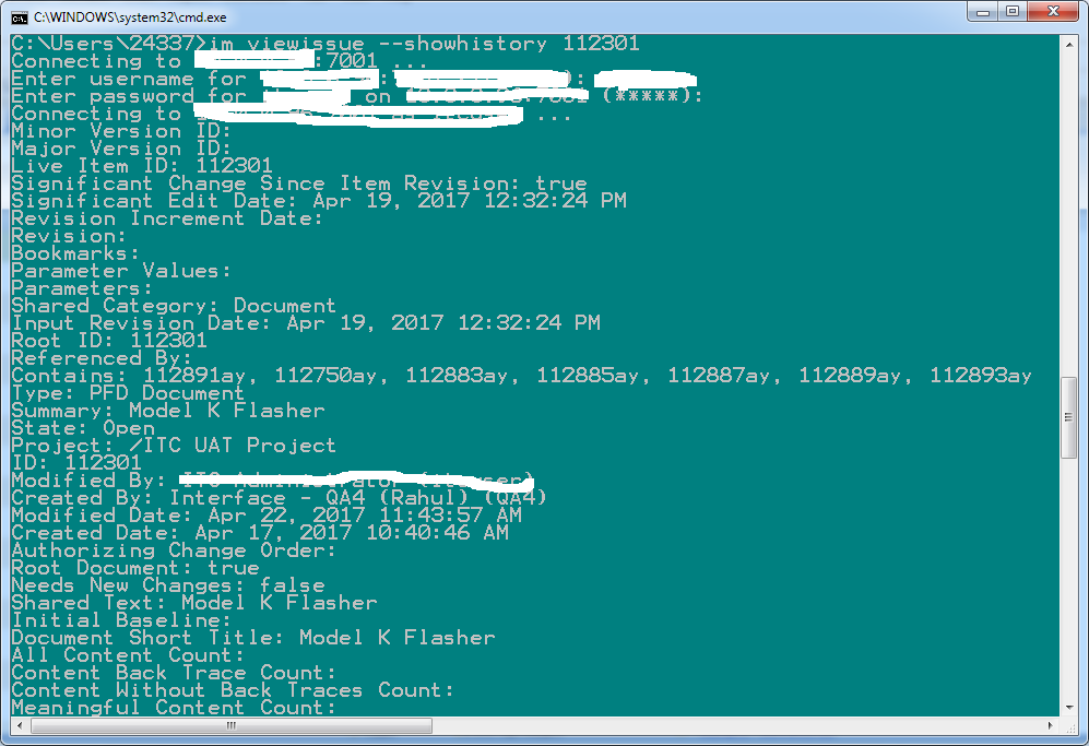

Hi Walmir,
I tried to run this command in different-2 scenarios but this is working perfectly for me. PFA screenshot for the same.history.png
Am getting every single details about respective ID.
Regards

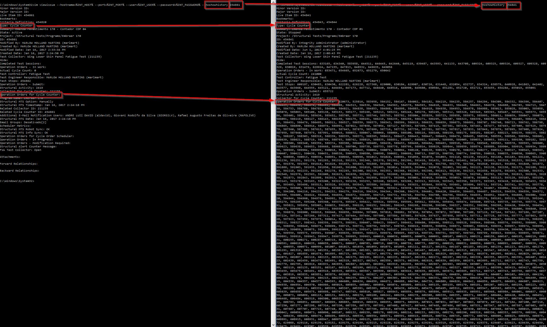

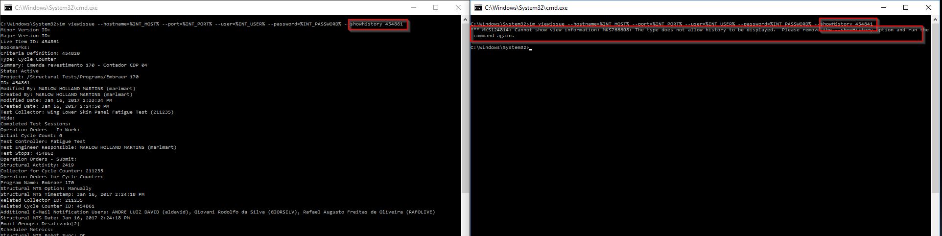

Hello Kapil, in the images, left 454861 (Ok) and right 454841 (Error).
Running "im viewissue --showhistory 999999" I receive the error:
Running "im viewissue --NOSHOWHISTORY 999999" I have identified that in ISSUE 454841 (Error) the relationship Operation Orders for Cycle Counter has many related Issues:

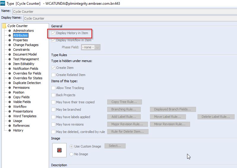

The "Display History in Item" is True:
Does it rings a bell?
