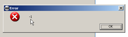

The MKS Integrity Client 2009 produces an error when I try to open the application, and blocks out my computer. The error is an window with title "Error" and the only text "-1", and thats all. The application enters a loop showing this error, and have no other choise than reestart the computer.
I'm running MKS Integrity Client 2009 with service pack 6 in a Windows XP Pro computer for more that a year without any problem. The error started after I installed either the last Windows XP updates (around 8th to 10th -Oct-2013) or LabView 2010.
This is the error windows:

    We faced this problem several times with 2009 and it might be related to the following scenarios:
    - You have had a project/sandbox view open ans selected inthe client the last time you used it. this project or sandbox does not exist the server anymore.
    - Your Admins changed some relationship fields that were use in relationship view you have had opened the last time your run the client.
    - some other magic we don't know
    A good way to solve this was to rename/remove the "IntegrityClient.rc" file in your user home. This is the place were all the settings from the last run are stored.
    In Addition you can rename/delete the ".mks" directory in your user home, where all customized view and viewset related data is stored.

    Thanks for your support. As you pointed out, I could solve the problem deleting the .mks directory from my home folder.

    This was due to a problem with the viewset being loaded upon client startup. It was really a JVM problem and has been fixed in the Integrity 10.0 and later releases. As already pointed-out, deleting/renaming the .mks folder will fix the problem since it contains the current client viewset files and the folder will be recreated on next client startup.
