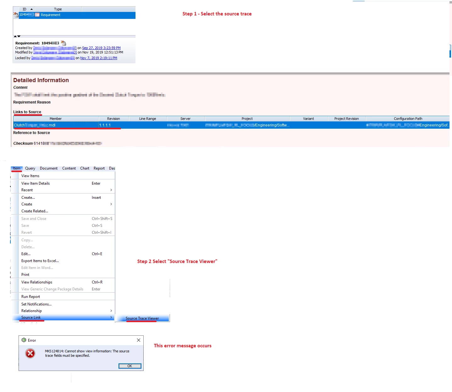

MKS124814: Cannot show view information: The source trace fields must be specified
In the Integrity Workflow and Documents I do these steps
1) Open a requirement
2) Select a source trace field to a member and select Item > Source Link > Source Trace Viewer.
3) I get the following error: MKS124814: Cannot show view information: The source trace fields must be specified
See attached file please
6 replies

From the screenshot, I have a feeling that your Link to Source field is a source link and not a source trace.
Therefore the source trace viewer doesn't know what to do and you get the error.
Try to double-click on the file listed in the field instead of using menu options. Then see where that takes you.
If you have admin rights, you can also look at the definition of the field to confirm its type.
Let us know what happens please.

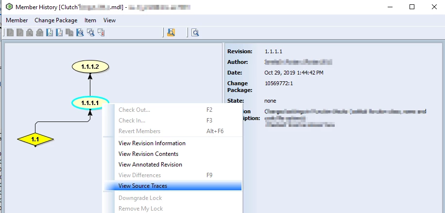

Double-click opens the revision 1.1.1.1 in the Member History (in Configuration Management)
See attachment

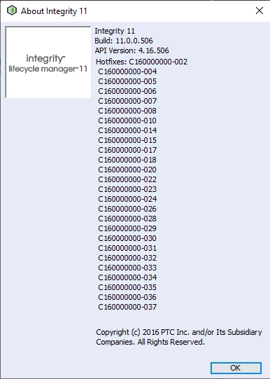

We are using Integrity 11.0.0.506 with service packs up to C160000000-037
I also verified these links, but it didn't help
